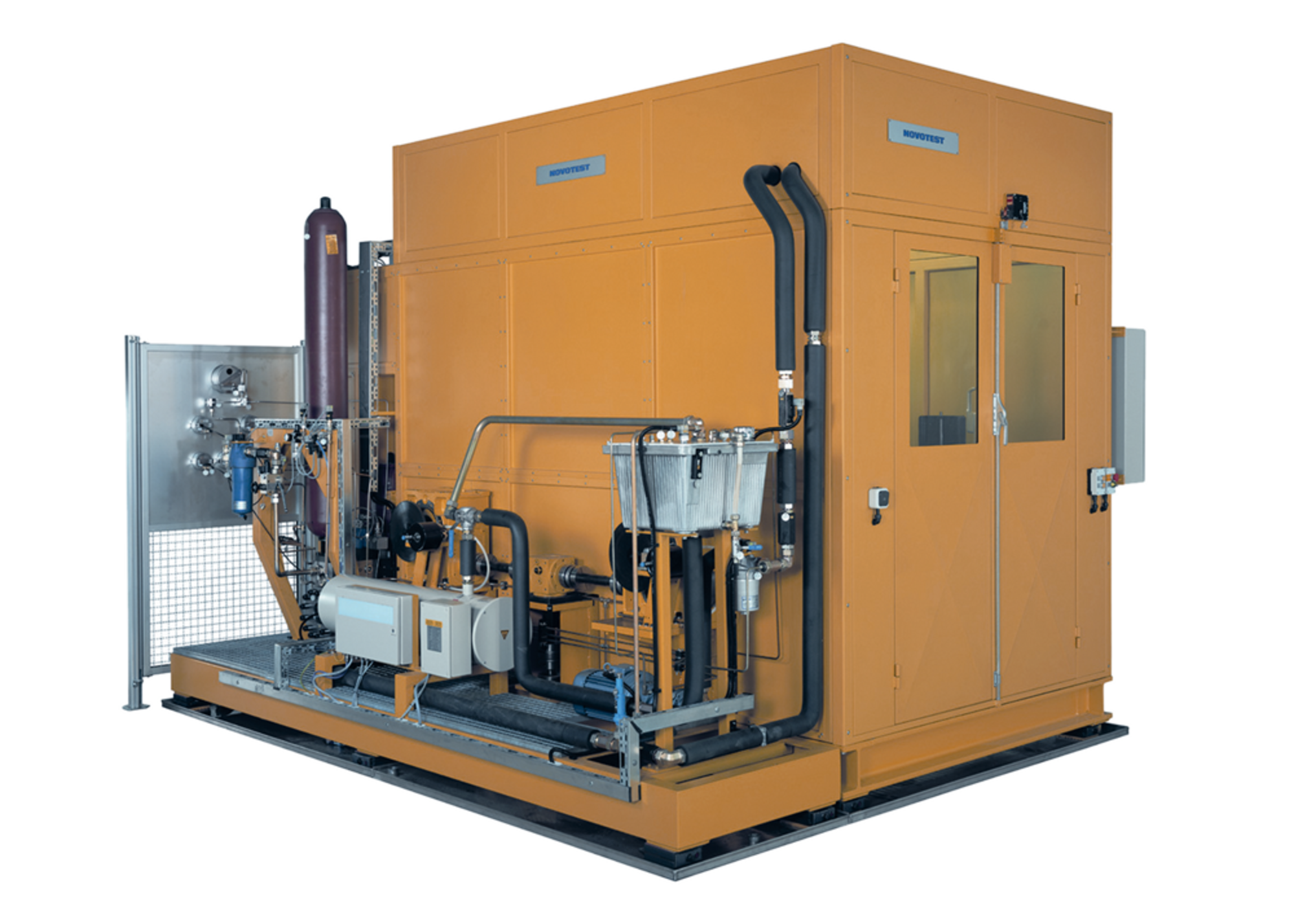

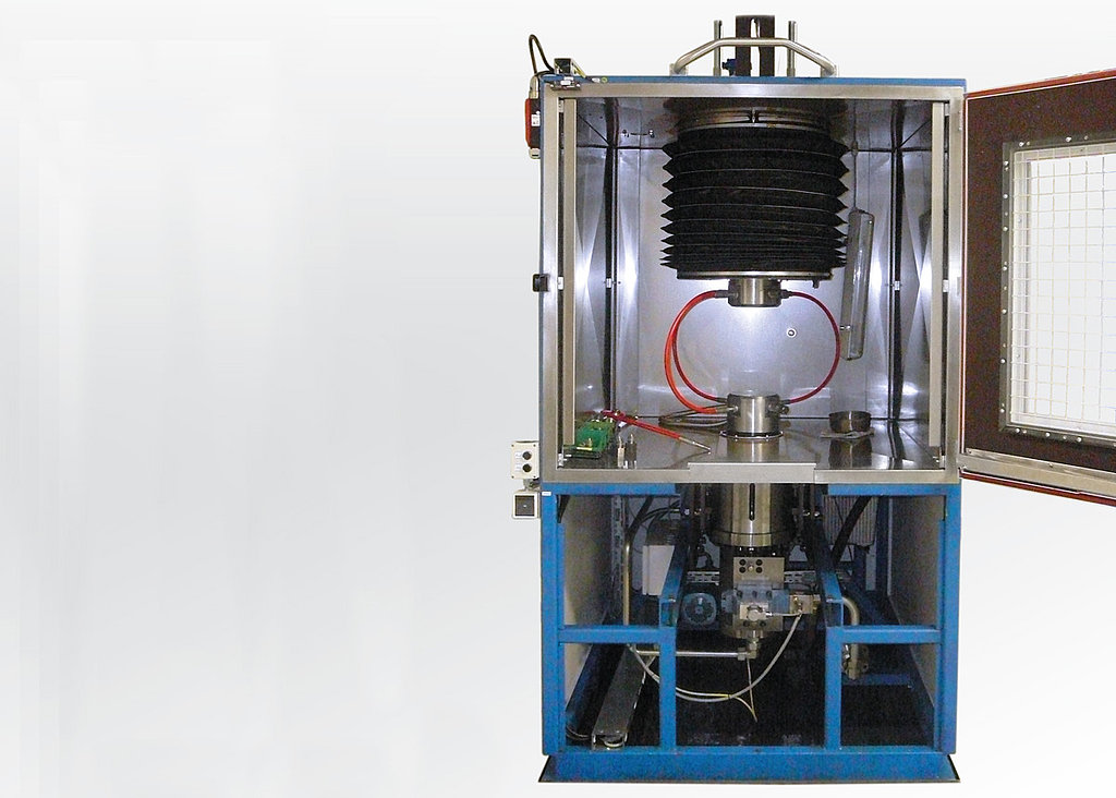

The impulse test bench was designed for endurance testing of dynamic components under very high pressure up to 4000 bar. The test bench chamber is additionally equipped with a flushing unit for the test object. Maximum pressure generation up to 4000 bar by pressure converter system.

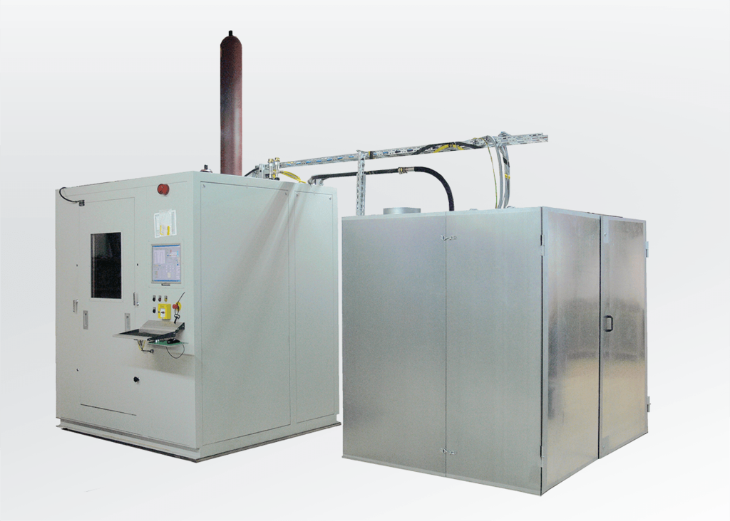

Low-pressure test benches for gasoline hoses are computer-controlled test system for performing static and dynamic tests on hoses and hose systems with test fluids from high hazard categories such as fuels. The safety concept of a test stand plays a critical role even during the development and design stages. Consequently, both the installation location and premises as well as the volumes of the test fluids and fresh air exchange are thoroughly researched and designed in cooperation with the subsequent user.

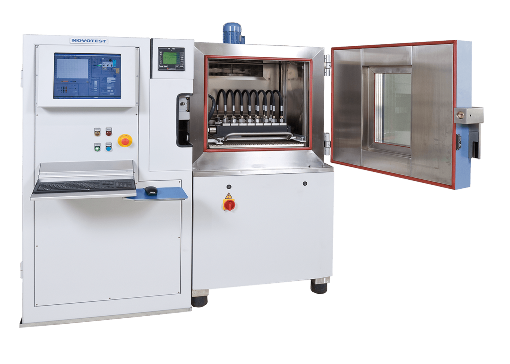

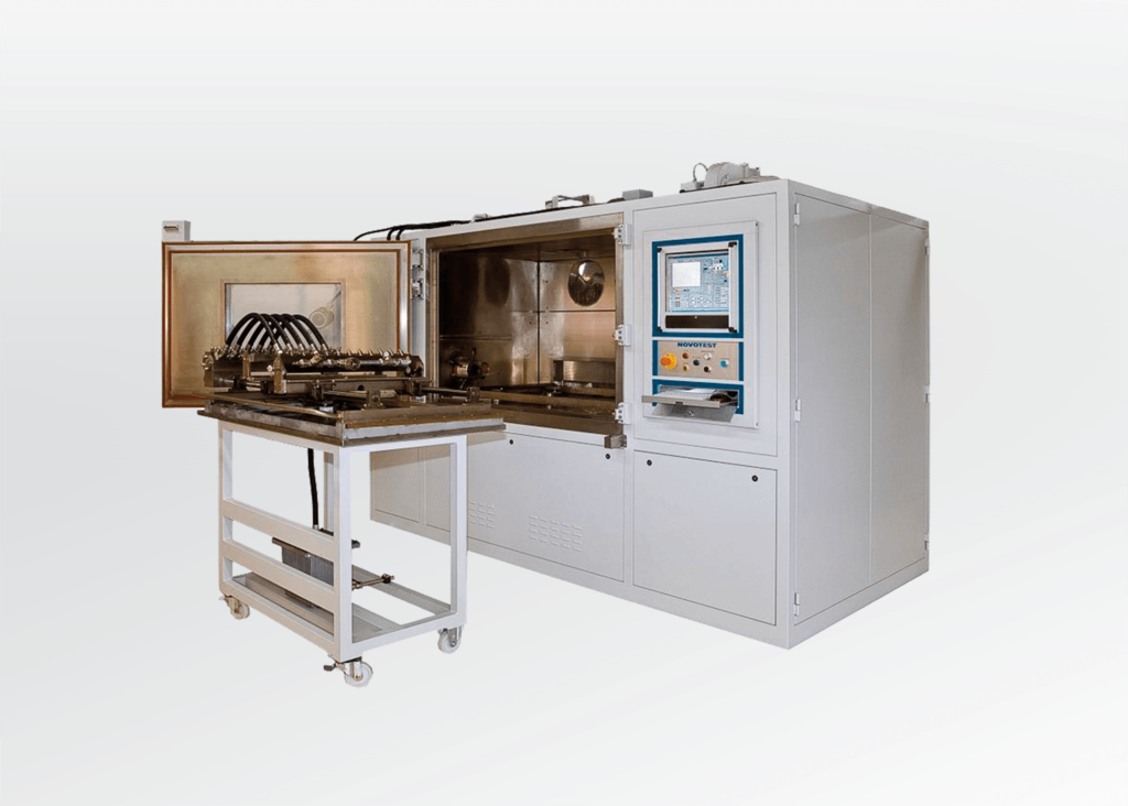

The test benches for the automotive industry offer connection options for up to 24 specimens. A special feature of the tests is the ability to perform reliable tests at temperatures ranging from -40 °C to +180 °C. The pressure intensifier installed is designed for a pressure range of 50 bar to 320 bar.

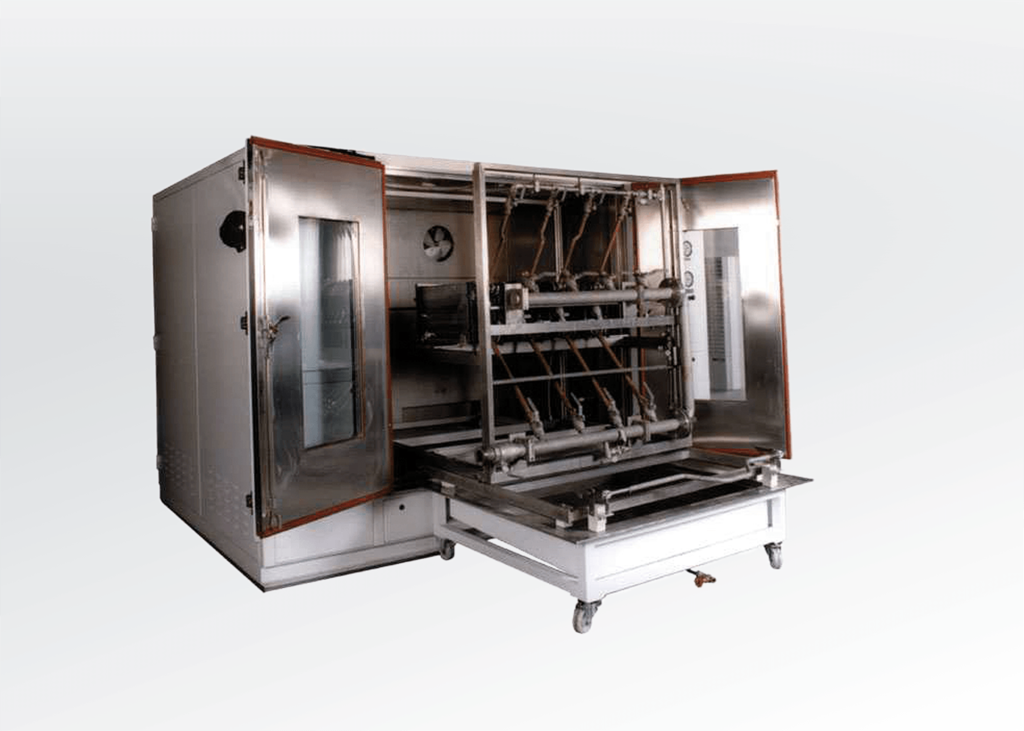

The impulse test benches are used to perform life-cycle tests for coolers. In addition to various pressure functions, the specimens are subjected to different temperature ranges. In this context, customer-specific requirements such as rated outputs, type of temperature control and rapid alternation of specimens are taken into account.

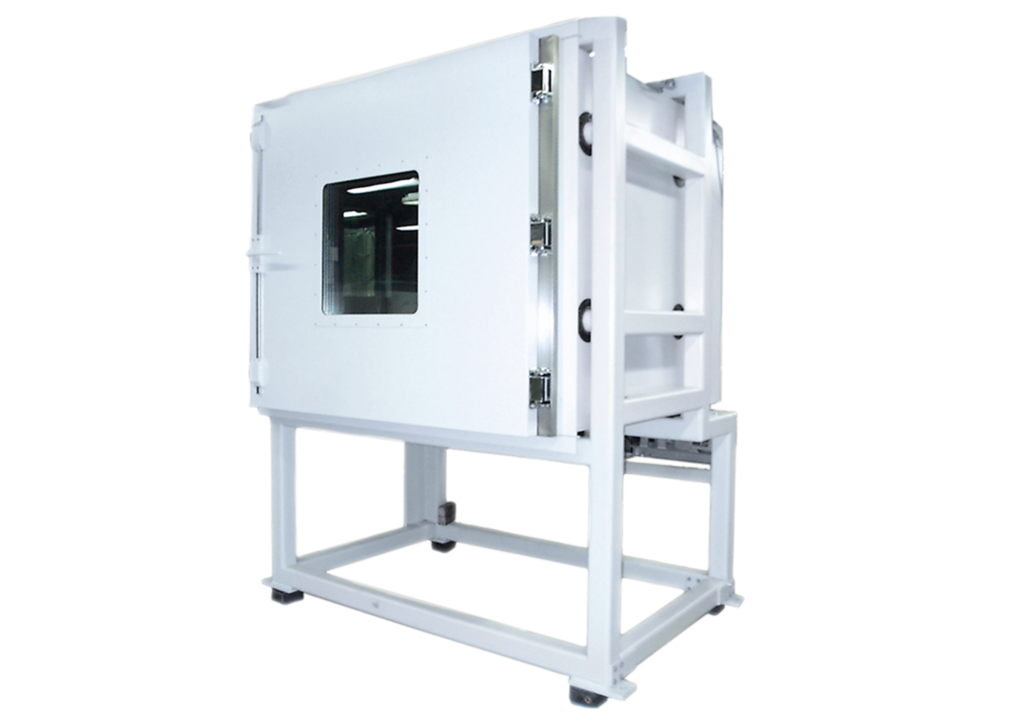

The test benches are optimised for industrial testing norms, some of which use large hosediameters up to 2” as well as fluid temperature control up to 160 °C. The test stands are equipped with a walk-in chamber and pressure intensifiers for pressure ranges up to 1500 bar.

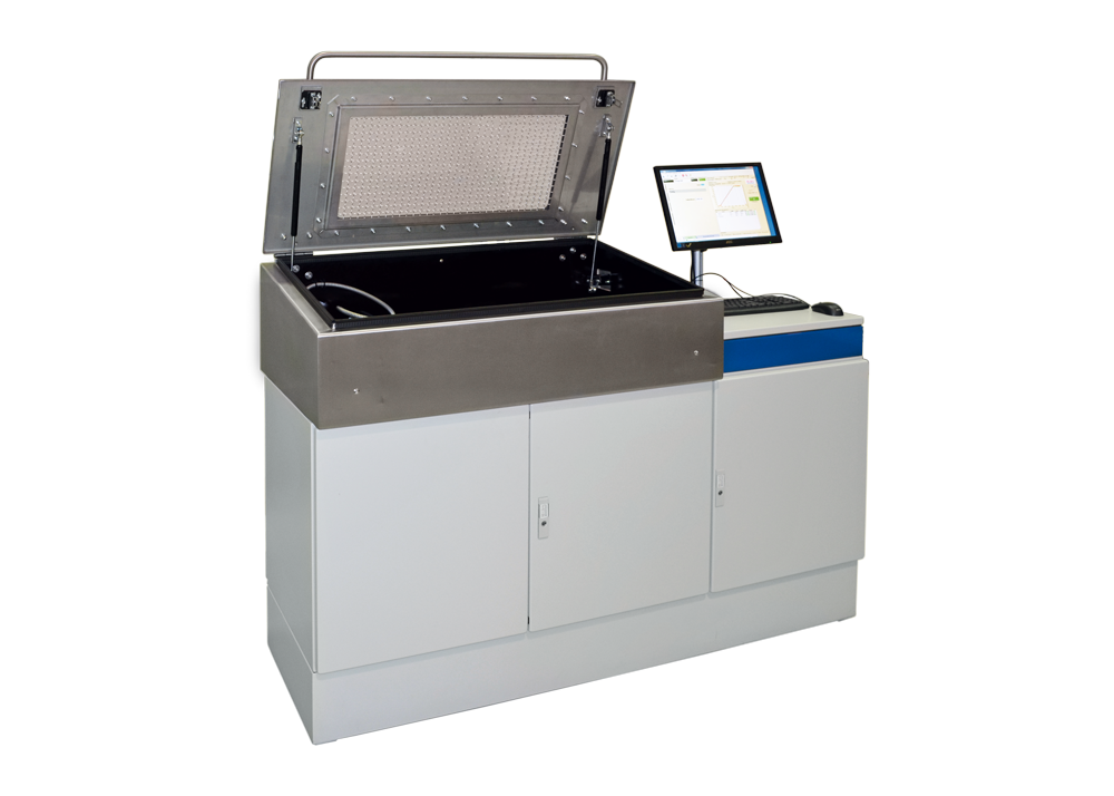

The test bench is designed for burst testing of hydraulic hoses or pipe sections at a max. pressure of 3000 bar. The key components of the test stand are a test chamber fitted with a polycarbonate window in the cover, a filling mechanism for the specimens, a pneumatic pump for generating pressure and a control system for controlling the test stand. The test stand can be equipped with an optional measurement of the change in length and with an additional sensor that uses another measurement range.

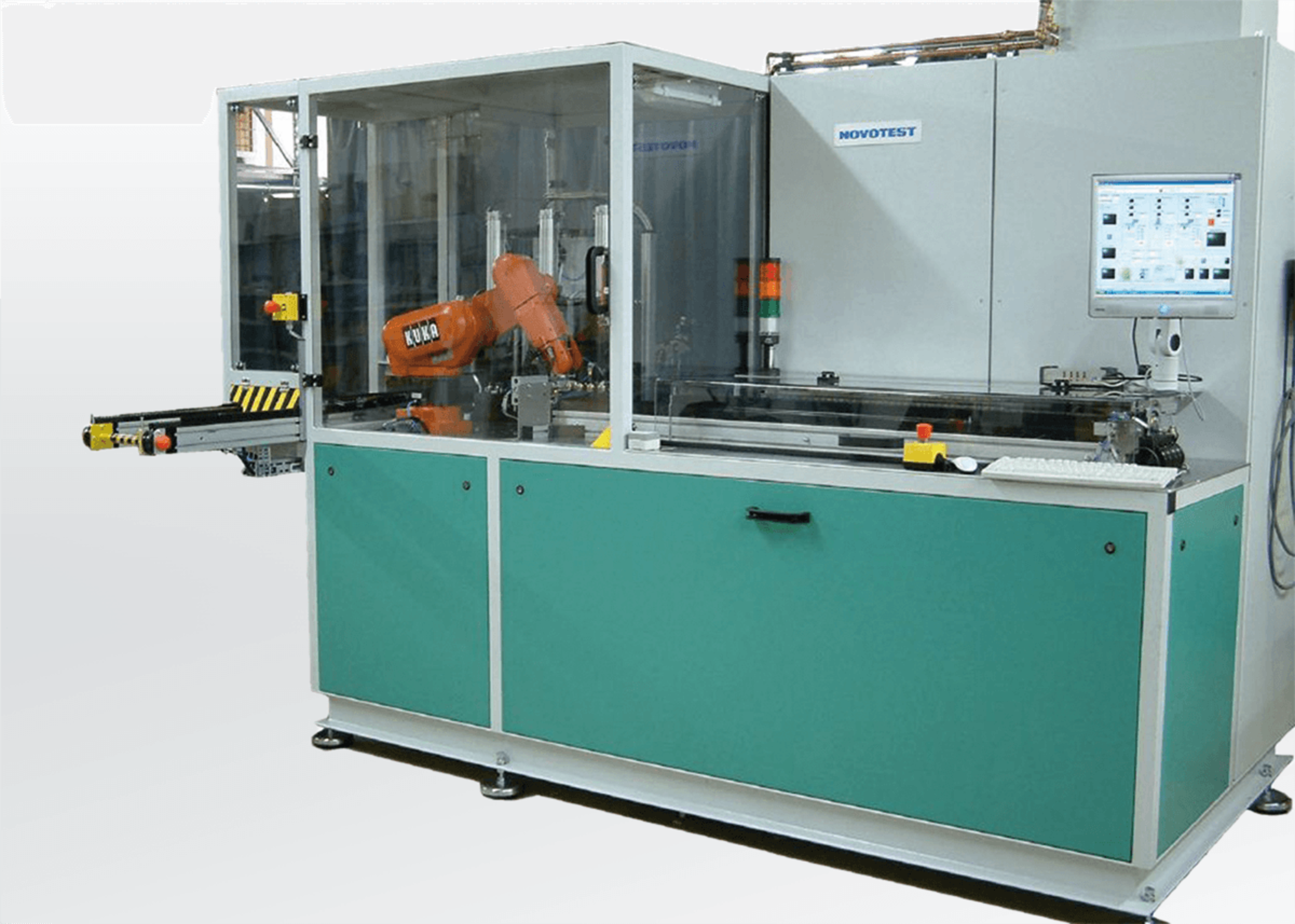

The system consists of two autonomous conveyor belts, each with one loading section, 20 pallets, 3 test stations with drainage device as well as an unloading section with trays. All test stations with clamping devices feature identical designs. The test consists of the following individual tests: Piston setting, function test, leakage measurement and characteristic curve determination. At the end of the test, the valve tested is drained.
The NovoPS test stand software is a Windows-based solution that is programmed in-house and optimised for the respective test task. As the interface to the user, the uncomplicated user interface provides intuitive access to all functions of the test stand. Moreover, both the connection of the test stand to the customer's conveyor systems as well as its integration into the existing network environment is taken into account. This enables the data acquired to be processed and evaluated independently of the test stand.
