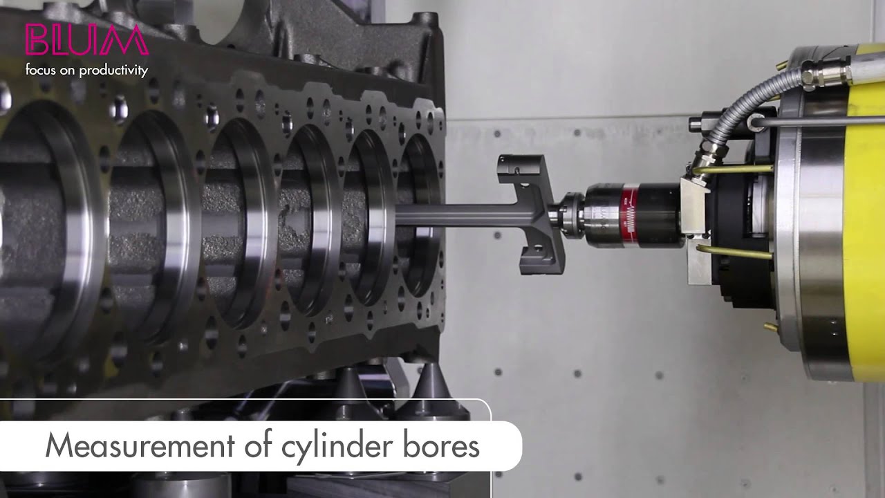

BLUM Bore Gauges
Bore gauges by BLUM can be used for the following measurement and monitoring tasks in CNC machining centres and transfer lines.
Diameter Measurement
Automatic and rapid acquisition of bore diameters (> 3 mm) in the original setting.
Adaptive machining
Determination of parameters for adaptive machining and process control between and after the machining steps.
Coolant load
Reliable and fast measurements in coolant thanks to robust design and modern measuring mechanism.
Mass Production
Perfectly suitable for mass production under the harshest conditions.
Wear compensation
Tool wear is compensated for by taking measurements on the workpiece and comparing these with the nominal dimension.

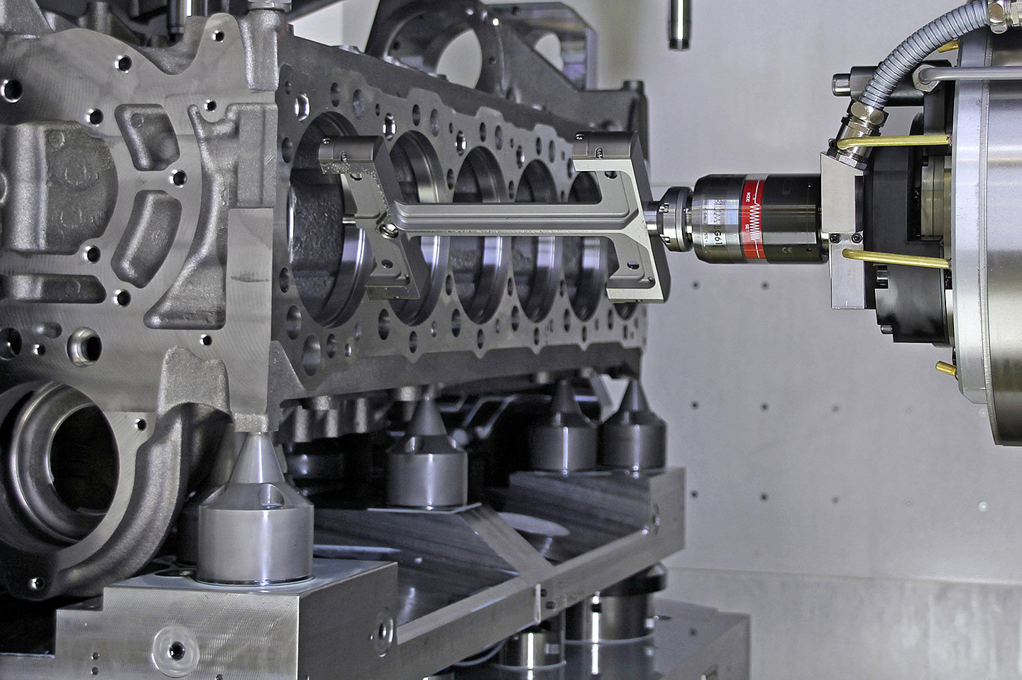

Bore Gauge BG61
  • Data transmission with BRC radio technology
  • Diameter-specific measuring head
  • Resolution: 12 Bit / 0,15 µm
  • Protection class IP67

Measuring a truck crankcase using BLUM BG61
