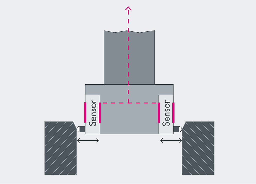

Bore gauges by BLUM can be used for the following measurement and monitoring tasks in CNC machining centres and transfer lines.

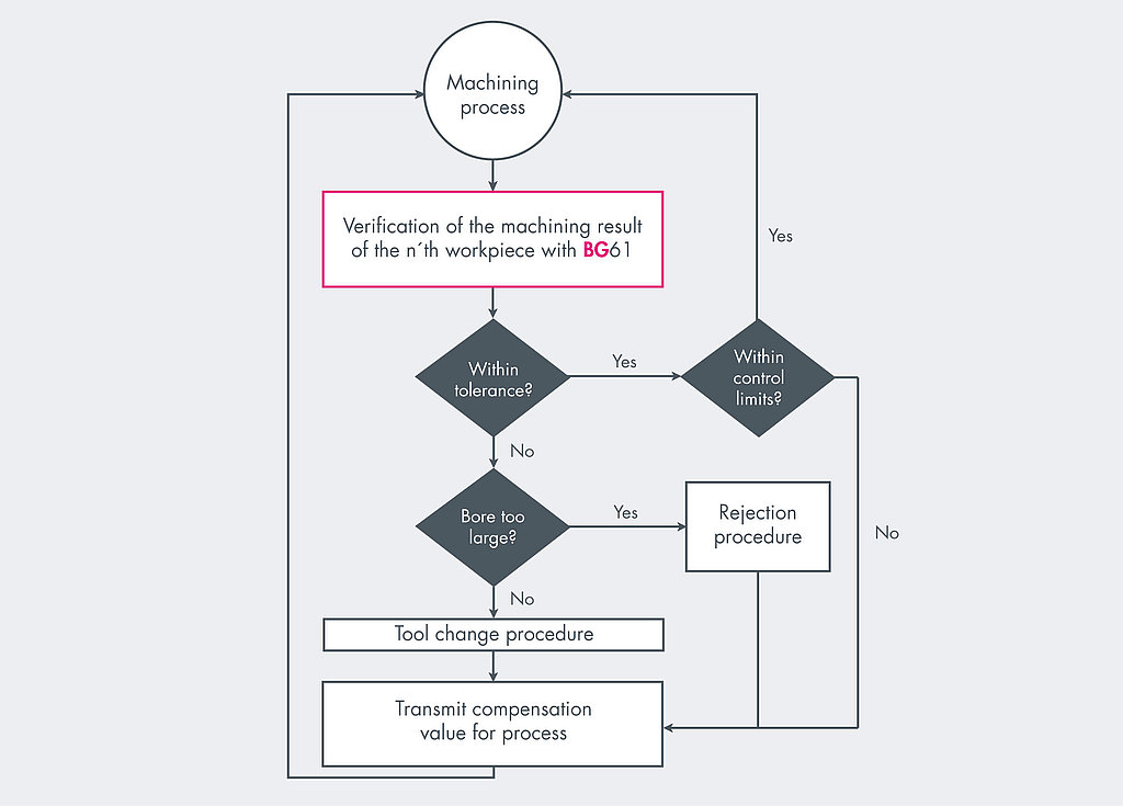

Automatic and rapid acquisition of bore diameters (> 3 mm) in the original setting.
Determination of parameters for adaptive machining and process control between and after the machining steps.
Reliable and fast measurements in coolant thanks to robust design and modern measuring mechanism.
Perfectly suitable for mass production under the harshest conditions.
Tool wear is compensated for by taking measurements on the workpiece and comparing these with the nominal dimension.

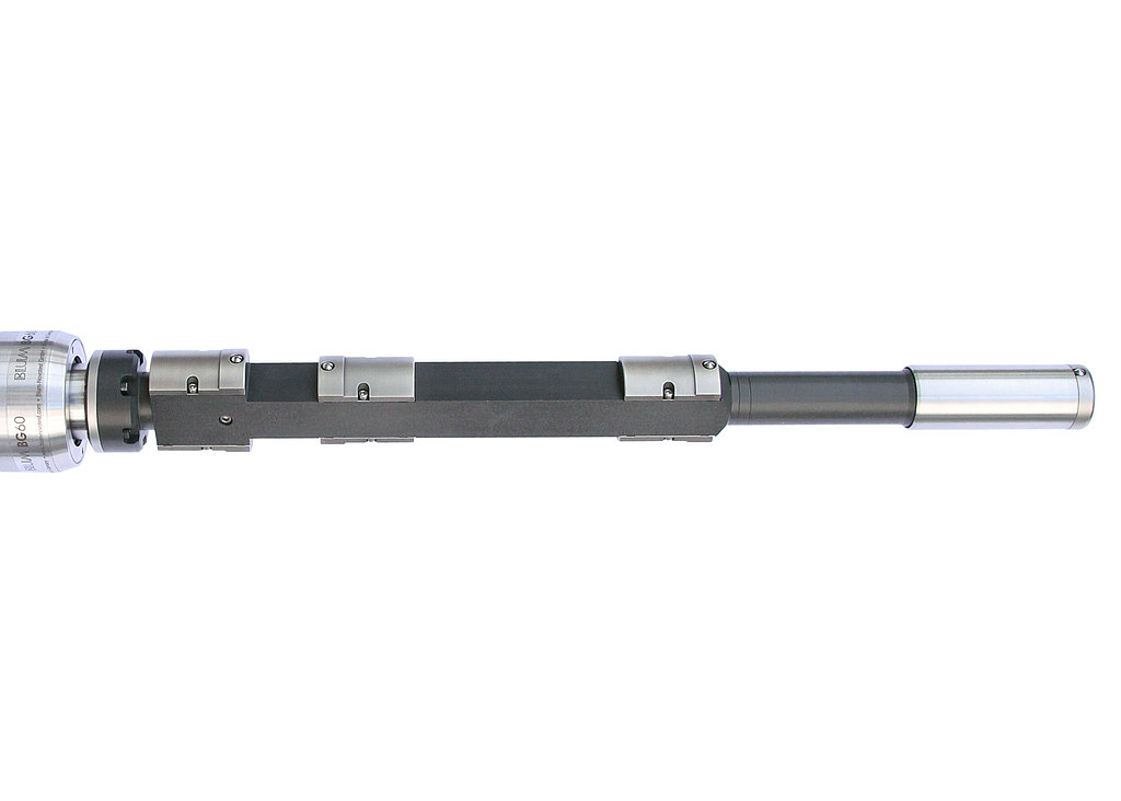

Bore Gauge BG61
Automated bore measurement of a truck crankcase with BLUM BG61
